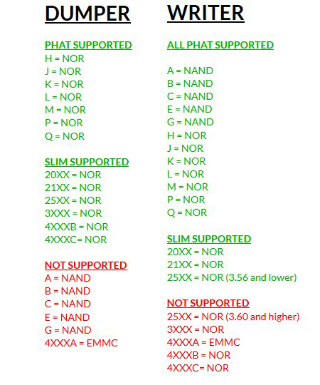

Is a Quick Compatible Console Chart Available ?

How do i know for sure if my PS3 Model is compatible ?
  • You must have a PS3 Console that has a Factory Firmware of 3.56 and below.
  • To check, its easy with this simple tool for OFW, Download minverchk.rar
  • Then place the .pup file on a FAT32 USB Flash Drive in a PS3/UPDATE folder (create path if needed)
  • Now on the PS3 XMB goto Setting ->> System Update >>> Update via Media Storage
  • Once shown on the list select the PUP and install, shortly after there will be a message showing the factory firmware the console was shipped,
  • For this we want 3.56 and below.
  • ANYTHING HIGHER THEN 3.56 IS NOT ABLE INSTALL A CFW. Sorry this will not work for your console, but there could be a HEN (Homebrew Enabler) possible for running homebrew, but additional research and time is needed for achievement, additional details can be read here.
