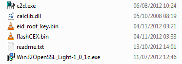

  • First download and extract the c2d_openssl.rar to C:/ and install openSSL, this is required for c2d to work properly. Make sure you rename the folder to "openssl".
  • Now take you eid_root_key and your NOR/NAND dump and place in the folder with c2d.
  • Rename your original CEX dump to flashCEX.bin
  • Add .bin extension to eid_root_key.
Should now have a folder like this:
1pauy

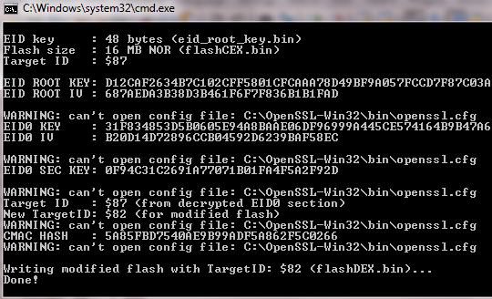

c2d.exe eid_key_file.bin in_flash.bin out_flash.bin [target_id]
1pbbu
Should give you an output like this:
1pbNZ
If you are unsure you have done it correctly, you can convert back to your original target ID (mine is 87)
Then compare this one with your original and they should match.
