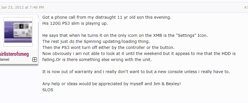

This guy also appears to be having the exact same problem:
